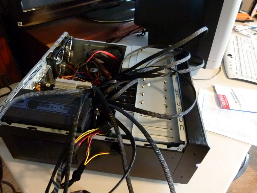

Not sure if were talking about the same Highpoint Raid Card, but I use a RR2680 in my WHS 2011. It actually has Two Mini-SAS connections that use two fan out cables that allow you to attach 4 Sata drives per cable, for a total of 8 Sata drives.
Posted Image
Posted Image
http://www.amazon.co...60&sr=8-2-fkmr0

  • 8 posts
Posted 11 December 2011 - 12:43 PM
Vinylfreak,
Thanks for the pictures and clarification. I don't think they are the same controllers but same idea. I think I'll be spending a lot of time on these forums picking peoples brains because this is all new to me
